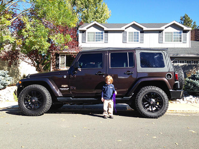

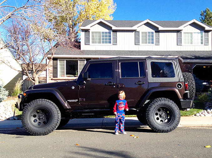

And finally, for the curious, here's the visual difference, complete with my wheelin' buddy so you can see the difference in height compared to him as well as the rapid effects of Fall in Colorado.
BEFORE
Attachment 582915
AFTER
Attachment 582917
