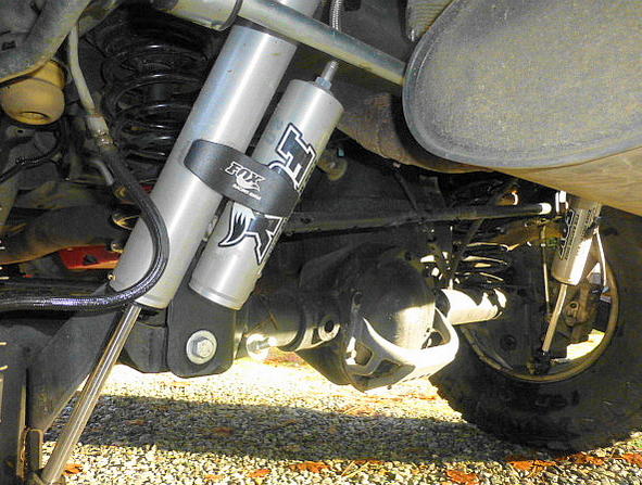

I'm running the plush coils with Fox remote res shocks(I too originally had 5100;s). I will agree that the on road ride isn't as soft as expected, given the Fox shocks are also a bit stiffer on road then my old Bilstein 5100's. However, hit a dirt road, pot holes, speed bumps at high speeds, this set up really shines. Makes washboard smooth, soaks up heavier hits beautifully. Like WOL has mentioned too, that ride quality and feel is very subjective to each individual. For me I love this set up, especially being I started with RC's 'rough' lift. Hit some rough roads/trails with these coils though and they'll stand up to their title of 'plush'. Happy Jeepin!Click image for larger version

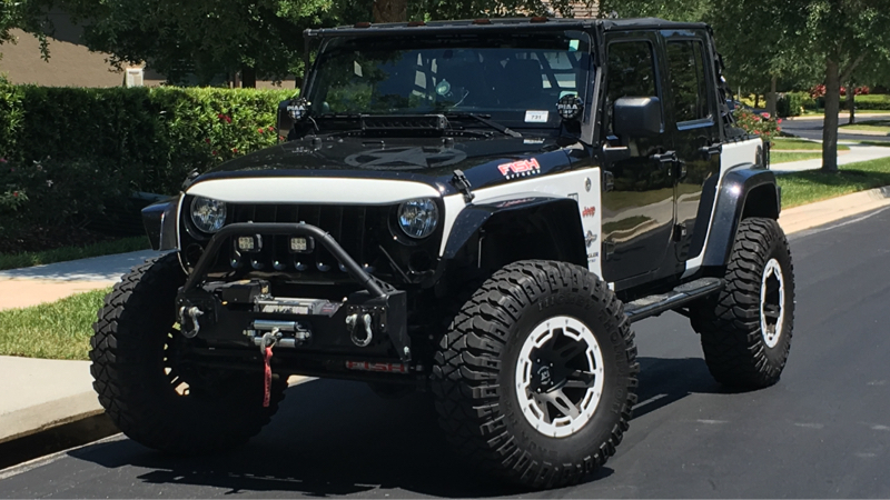

Kinda resurrecting this thread. I have the Evo Plush coils with 5100's. The ride is great on the highway, but I still feel the washboard bumps or brick roads are kinda harsh. It seems pretty intuitive, but I'm wondering if my issue is more with the light weight of my 4dr. I run it with a Trektop NX; no spare; no skids or heavy armor; no steel flares; light frame-rail caps vs heavy steel rear bumper; and a light front bumper with a winch. Do you feel the lack of weight is contributing to the harshness on some bumps, vs weight that would aid in compressing the shocks and springs?
Are your 5100's tuned to the coils, or just off the shelf?
I am running different coils, but I thought the 5100's were a very stiff shock. My ride improved quite a bit after changing to the OME's that MC recommended for their coils.
Without knowing the coil and shock rates, might be hard to say whether adding weight would help.
