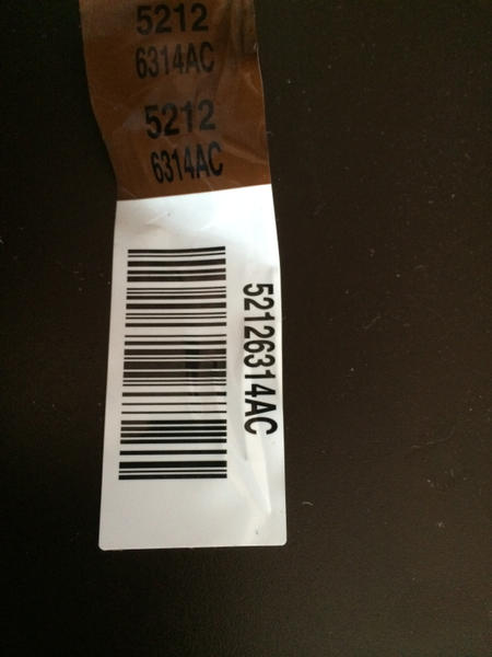

Hi fellow forum members, I was looking into getting the mopar heavy duty coil springs and was wondering if anyone has experience with these? I recently traded in my beloved 2010 jk for a new 2014 jk rubicon which is completely stock. I am looking for something that will provide a slight amount of lift and will also keep the factory rake. Also, I will be towing a pretty heavy camper and thought these will help. They advertise that these springs may provide 1" of lift. Any opinions?

Manufacturer Part No: 68004256AA
This is the part number for the mopar heavy duty rear spring so it looks like my jk already has the same exact springs.
I agree with^^^^^^. You apparently have 14/56. You will see a hug improvement if you upgrade to the 19/60. I went from the same as your to that and I got almost 2" of lift. Also, the springs being stiffer really helps when I tow a small trailer.you can prob find a good set on here of Craigslist for $100-150.
