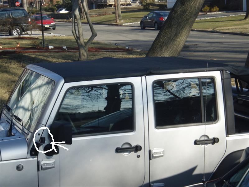

Originally Posted by wrnglrguy
marked pic...
Attachment 9821
On the original thread this pic is from, someone pointed it out. the owner said it is not dented, just looks like it in the pic.
I agree, if you look close it is just the shadow of the OEM mirror
Looks like in the pic posted above, that the door IS dented. Look just to the rear of the bracket...
Attachment 9820
Guys, although it may look like it to you beady-eyed watchers that's NOT a dent. Here is the original thread I borrowed the picture from https://www.jk-forum.com/forums/show...warrior&page=2
Having the Warrior brackets I agree 100% with the remark written owner on that thread "Although it may look like it, I can assure you there is no dent on the door. The brackets dont come close to hitting the doors. If you leave the mirror in the bracket, the mirror will hit the door".
Yes, if you have the stock mirrors on the Warrior bracket AND leave the doors on (pointless, cos having the brackets is so you can take the doors off) then yes, the black plastic mirror surround does rub on the thin outside seam-edge of the door, but it will not dent. In the winter when doors are back on and side mirrors are in their original position on the door, the Warrior bracket does not rub on or dent any part of the door when wide open.
You choose which mirror relocation bracket you think best, I'm delighted with the Warrior brackets after the 2-min fix.
