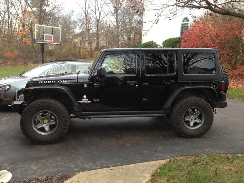

Here is mine with 35s, bushwhackers and a teraflex leveling kit. No rub until I put the bumpers on. I need to upgrade to the performance leveling kit to remove the minor rub on full compression in the rear.
Attachment 400459
Attachment 400459
