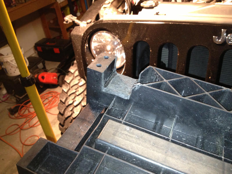

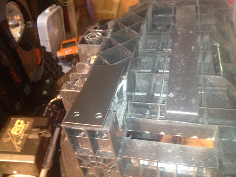

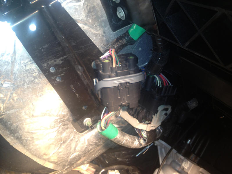

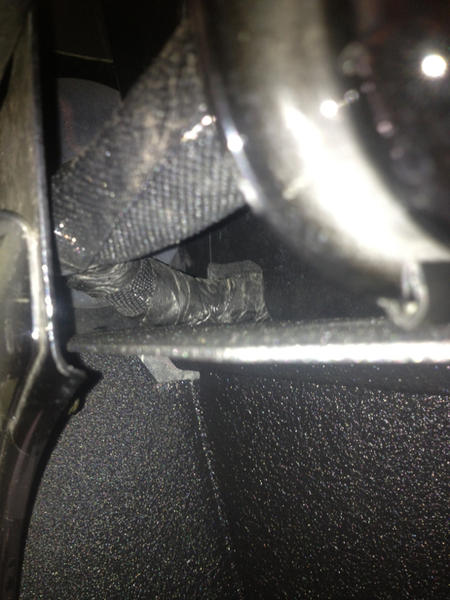

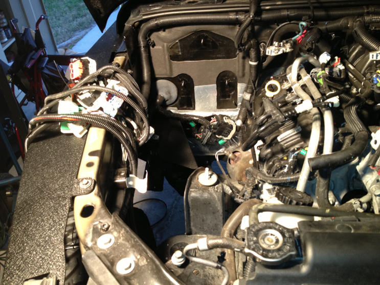

This write-up are for those of you who found the passangerside back plate more than an awful fit. The problem was that the wiring harness prevented a flush fit and so I took the battery tray out and trimmed the tray as shown in the pictures. Metal cloak should of took this into consideration instead suggesting to simply push the harness out of the way and have it crimped between there fender liners and the plastic battery tray. Pics are in order.
