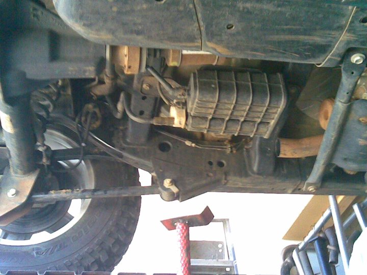

Haven't seen anyone yet who relocated it to a nice place, though I might show where i got it to fit. It's a 6" Magnaflow and sounds great not to loud or obnoxious. Afterward I just put half of the original heat shield around the box you see there.

I'm not sure about sunny Cal, but in Mass, the tip has to extend at least to the edge of the body. You probably have the roof off all the time (lucky b*****d ), so emissions aren't as much of an issue.
The Cooltech kit puts the muffler in front of the evap can, and the tip extends just to the edge of the body, but not out from under the bumper. You could do the same w/a longer tip.

I'd be interested in seeing if you get any exhaust fumes in the jeep at low speed with the top off. Please update when summer comes! I'd do the same thing if I knew it didn't. I have a buddy that had a 4 runner and when he cut the exhaust off close to that spot, it got fumes.
