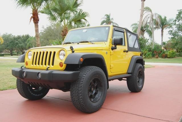

I am installing the lift Sat morning and really want to make sure that I will be fine with the 2.5 coil lift runnning 35's with aftermarket 17's and 4.5 BS... I have seen many RC 2.5 BB lifts with 35's but no 4 dr's running coil lifts

Here you go! RC 2.5" with 2.2 shocks. Very easy install. When doing the front get it up high enough to crank the axle down to get the spring in. Don't worry about pushing down too hard on the axle. On the rear, remember to take off the brake line bracket and put it back. Again, don't worry about cranking the axle down low enough to get the springs in easily. Last item: don't forget to recenter your steering wheel when done. Very, very easy there is a write up on here but it is basically, taking a 15mm wrench, lossening the 2 bolts and rotating the shaft. You will need to adjust a few times to get it right.
Oh yeah, I had to trim a little bit of the plastic "skid guard" since the tires rubbed a tiny bit at full turn. Now, I have the rugged ridge stubby bumper so it doesn't matter anymore.
