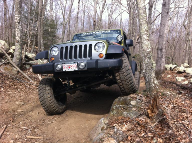

The 2.5" Max. Travel System is our personal favorite for your application.
Progressive Rate Front Coils
High Clearance Adjustable Lower Control Arms Front and Rear
Stainless Steel Brake Lines Front and Rear
H.D. Front Track Bar, Rear Track Bar Bracket
Disconnects up Front and Extended Links in the rear...
