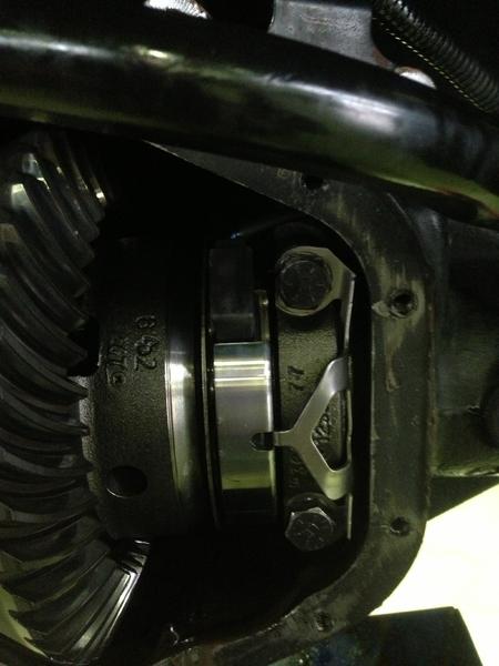

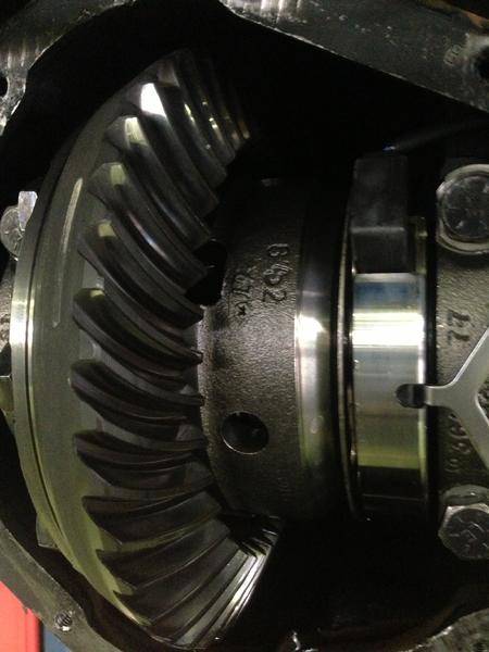

2012 Rubicon rear locker not engaging.
Hi Guys
I was hoping someone can help me. I also have an issue with lockers.
My front lockers engage perfectly and light stays illuminated, but rear does not engage and light keeps blinking.
At 10 000km they replaced the diff bearing cauase it was making a huge noise at low speed.
Now at 44 000km my diff lock is not working, but i do not know how long it has not been working, cause you don't always need to use it!

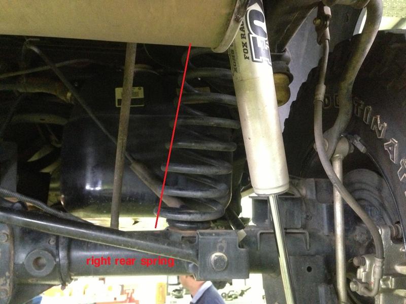

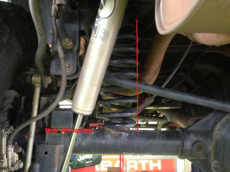

The dealership is saying i knocked my diff housing and "warped" the housing. And saying there is something wrong with the jeep cause my rear right shock spring is not straight.
I can't see how that effects the diff lock.
The report says that when they opened the diff cover they found a shim has come out of place. They put it back in place, but diff lock still not working.
they charged me for oil replacement, but still can't tell me why the diff lock is not working.
Their solution is to claim a whole new diff housing using my short term insurance because they say it is not covered by my warranty, our warranty in SA expires at 100 000km. Ridiculous!
Can anyone help me out any suggestoins i can try? Could it be faulty sensors? Faulty acuator? Anything???
Attached are pics of my diff cover open. if anyone can see anything out of ordinary please share.
Thank you.
