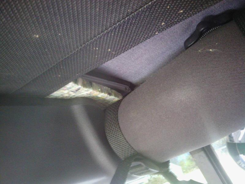

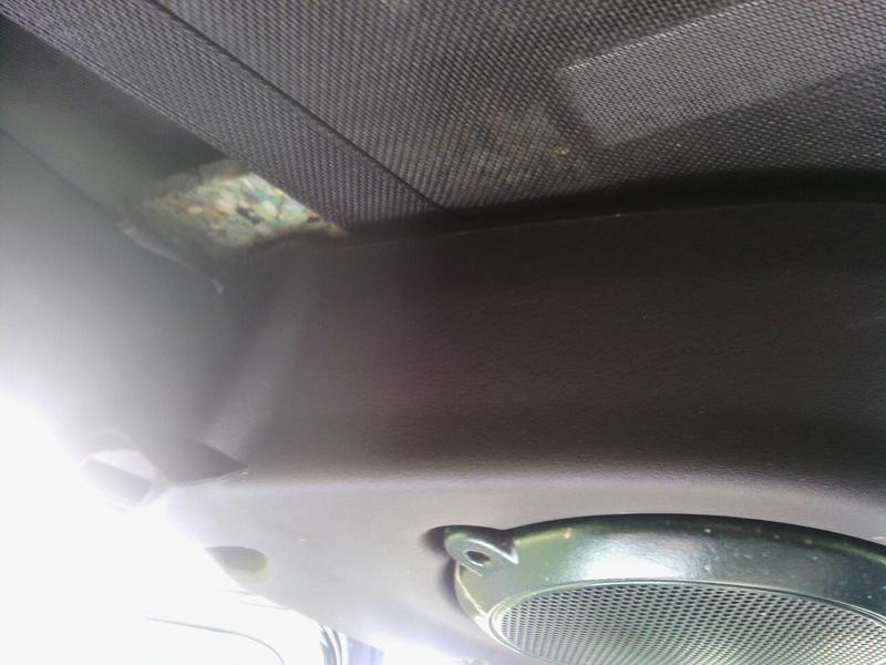

Its ur rear aluminum bar. I took carpet padding from a job site and stick it between the support and the sound bar. Problem solved Click image for larger version

ID:	548584u can use anything really too deaden the sound. Its just the aluminum smacking the sound bar.

Its ur rear aluminum bar. I took carpet padding from a job site and stick it between the support and the sound bar. Problem solved Attachment 548585Attachment 548584u can use anything really too deaden the sound. Its just the aluminum smacking the sound bar.
Sent from my obama monitoring device
does that help with the wind noise? because honestly i forgot about the bar smacking the sound bar and im definatly going to do that because that sound is annoying.. i was talking more like wind noise and crazy vibration.. almost like when you have one window down slightly if that makes any sense
