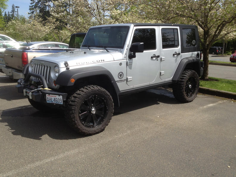

Here is mine with a 2.5" Teraflex budget boost and 33" tires. Good luck and welcome.
