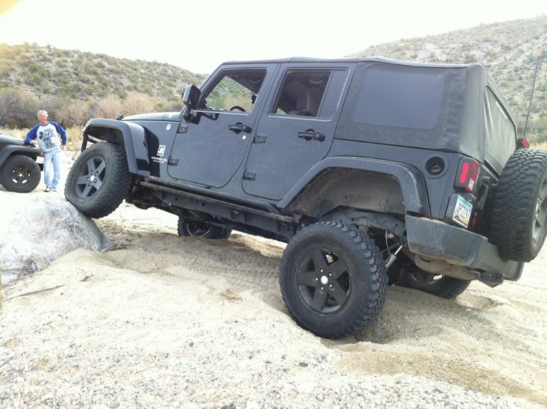

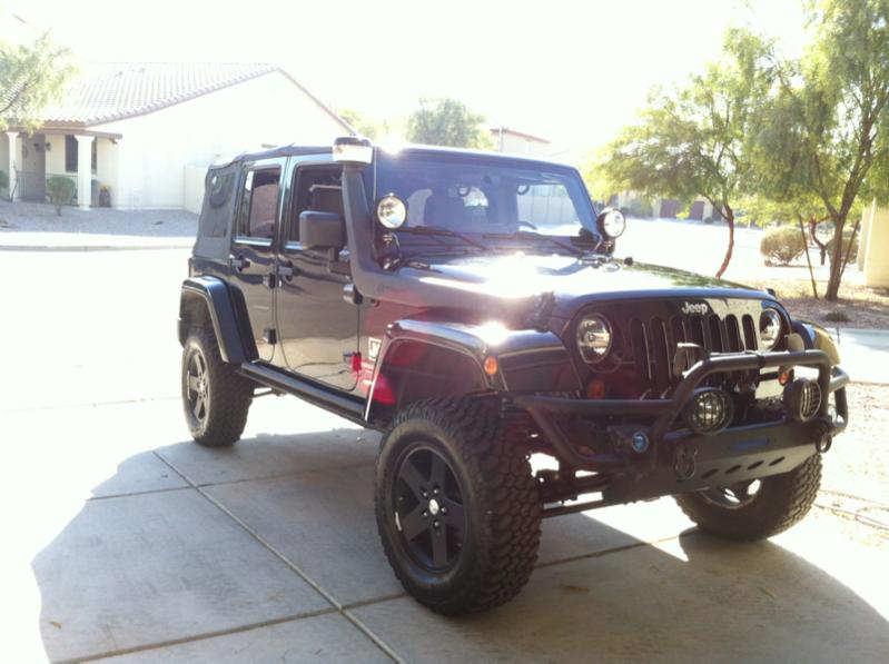

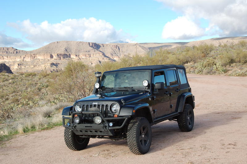

I have it and love it.
i highly suggest not using the drop pitman arm and trackbar bracket and just use an adjustable trackbar instead. The drop pitman arm can cause additional stress on the sector shaft/steering box
if you have a 2012 your also going to need to purchase the "exhaust extenstion"
