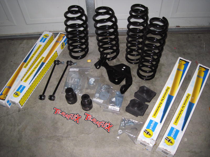

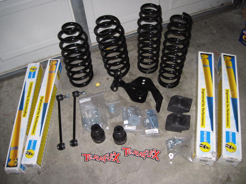

I have that same kit on my 2012 with shock extenders instead of replacing the shocks. You do not have to have it with that small amount of lift. It wouldn't hurt to have it either and it is on my short list of things to do next.
Sponsoring Manufacturer
You do not need a front adjustable trackbar with that kit. Your better off adding front lower adj control arms so you can dial in your caster correctly for you alignment.
