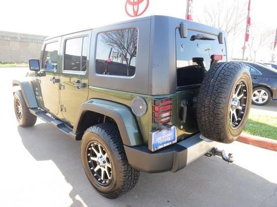

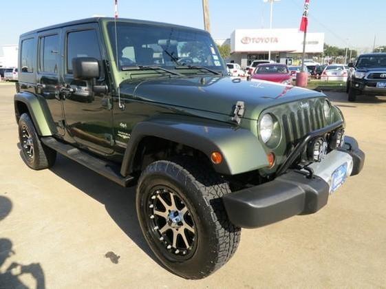

Howdy y'all,
I'm new to the world of JK's and have a question about lifts and when to change out drive shafts. First a little history of my experience. I've owned two other jeeps: a 1990 YJ and a 1979 CJ-7. Sorry y'all but hands down greatest jeeps are the CJ series IMO. I plan to get another 7 or an 8 but I had to compromise about a year ago when the wife and I had been trying to have kids for about six years but no dice. I sold my 7 so we could try IVF. (Luckily I was active duty Marine Corps at the time and we got a discounted rate in Raleigh cause our insurance didn't cover any of it!) Long story short it worked and I now have two beautiful twin girls that are about to be 8 months old: hence the wife wanting me to get a JK for their safety. I like it a lot it's just a little to high tech for me is all. To fancy a Jeep. Now about the jeep and my question:
It's a 2008 JKUS automatic (so the wife can have fun wheelin too)
Previous owner installed a TF 2.5" BB with Rancho shocks and an air raid intake. Performance wise, that's it.
The question y'all have been waiting for...
I am going to run the RK 5.5" X factor mid arm lift and 37" tires to start. (Planning on 40's later) in all my research I can only find things about changing the front drive shaft after 3". I should replace both for a 5.5" right? Your help would be appreciated! Thanks guys/gals.
