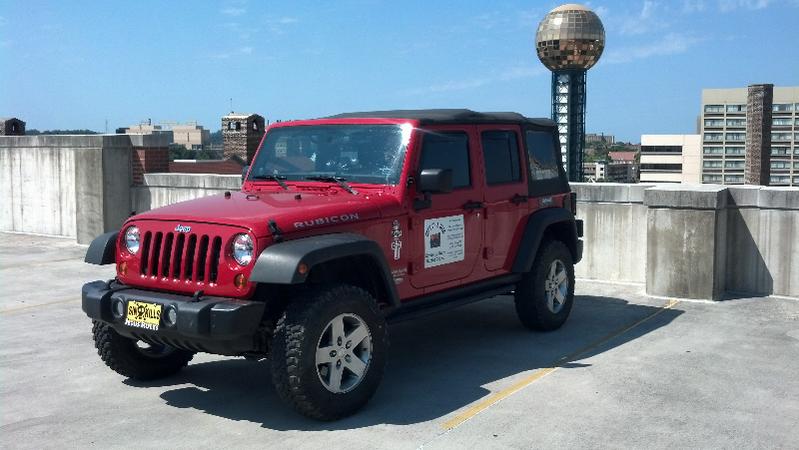

I've installed the teraflex leveling kit on two jeeps in the last two months. Works, looks and installed great. No change in ride quality and gets rid of the god aweful rake.
