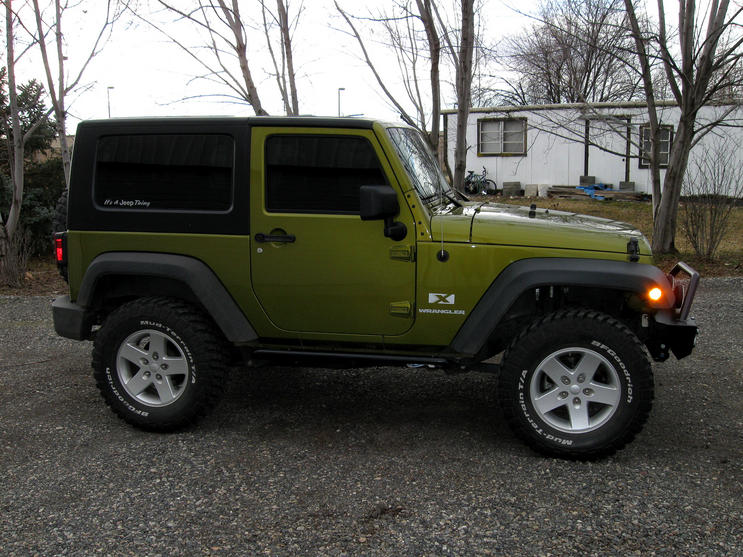

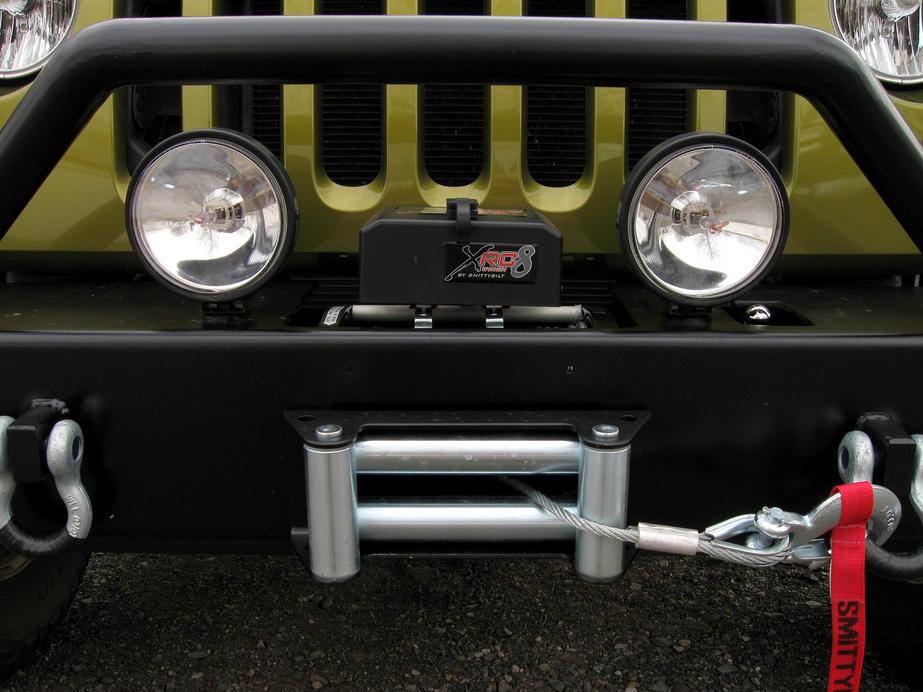

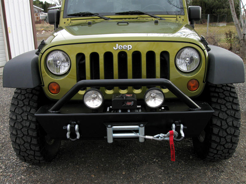

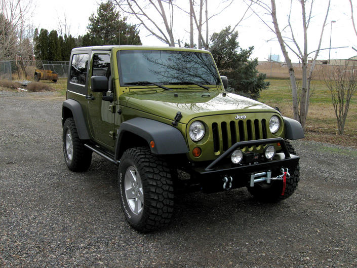

OK so My current set up is 08 jk x I have TF 2.5 BB, Set of BFG KM2 285/70/17
TF discos and I liked the way it sat. But I just Put on my new stubby front bumper,Home made fabrication! With a smittybuilt xrc8 winch And the nose took a dive. I have heard that the OME Springs are great Im looking at getting the Heavy Duty for the front and for the back I am thinking of putting on stack rubi Unlimited springs Cuz their free and free is me! What do you think Will the heavy springs give me too rough of a ride?

I've been through this too and hated the effect the additional weight had on the stance of the Jeep. So... Swap out your BB spacers and factory X coils for some TeraFlex 2.5" coils and your stance will be good again and a BIG improvement in the ride. The rest of the BB lift components are the same and remain installed so you're good to go !!!
And to save you some confusion when you get to this point... once you price the 2.5" Coils Only from TF you'll realize it costs the same as a full 2.5" coil kit... so do what I did and buy the complete coil kit, install only the new coils , drop your 2.5" BB spacers in the box and sell a COMPLETE 2.5" BB on this forum and get some money back on the deal

leveling kit!
