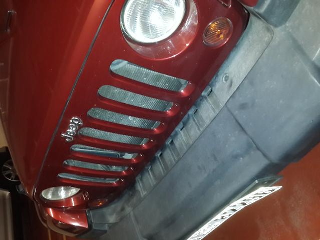

I just got a 2008 jeep wrangler and i bought RR bumper light bar, but i got no idea where or how the tube sleeves are suppose to go through the bumper!!!!! Any pics? *help*

I've got the instructions on a paper, but it seems that the bumper we got here in ME is different than the one in US!!! I will have to check when I wake up its 730am and I didnt sleep yet!! Thanks alot!!

Does it require the removal of the small plastic between the bumper and grill on top? Some manufacturers use that little bit of framerail to mount things.

I see...the Euro bumper is not the same as the US bumper. You would have to cut slots in yours to make this light bar work.
The US bumper has opening between the fender flare and the bumper...your bumper is molded right up to the fender flare.
