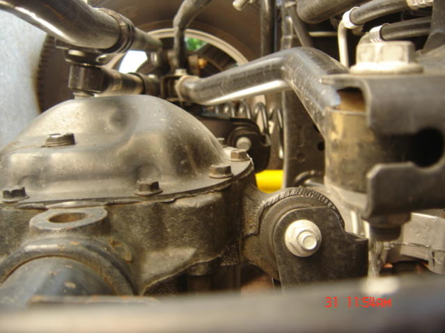

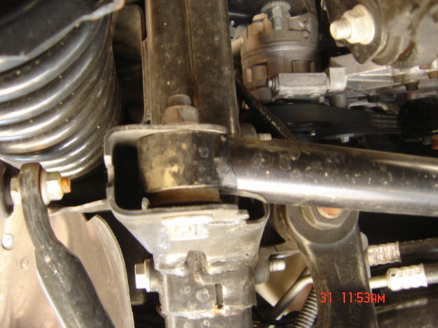

I would check the trackbar mount hole on the axle to make sure that it is not wallowed out. If it is wallowed out this will cause the trackbar to have some play in it.

I do know if this will help but, make sure your frame mounting bushing is installed from the rear. Also, i just used my Harbor freight ball joint press to push it out and in while still attached to the axle mount.

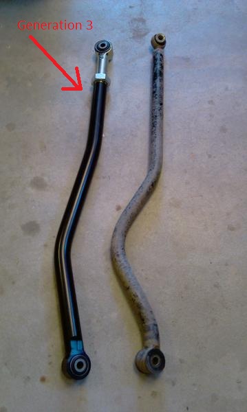

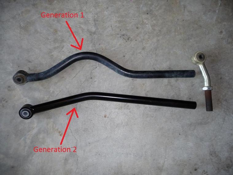

If you bought the track bar 1 year ago you should have the 2nd generation bar. They are on the 3rd and are working on the 4th. I talked to them and they told me because of the issues of the 2nd generation with bad bushings and flexing that they would swap them out for the new one for free. You might give them a call tomorrow and talk to their support and see if you can get a new one.
Thats the first I heard of JKS 3rd generation tackbar. I will call them today and c whats up. If I dont get a satisfactory answer I am tempted to get a new trackbar from Clayton. I cannot afford to F around with this, my jk is my only ride and I am scared to drive the damn thing now.
sounds like u have the old bar, and the 3rd gen is very beefy and alot bigger jamnut. u can also adjust 3rd gen in 1/2 turn increments, as opposed to 2nd haveing to make full turns for adjustment.
does your bar have a "arc" bend, or more of a straight shot down to axle??
