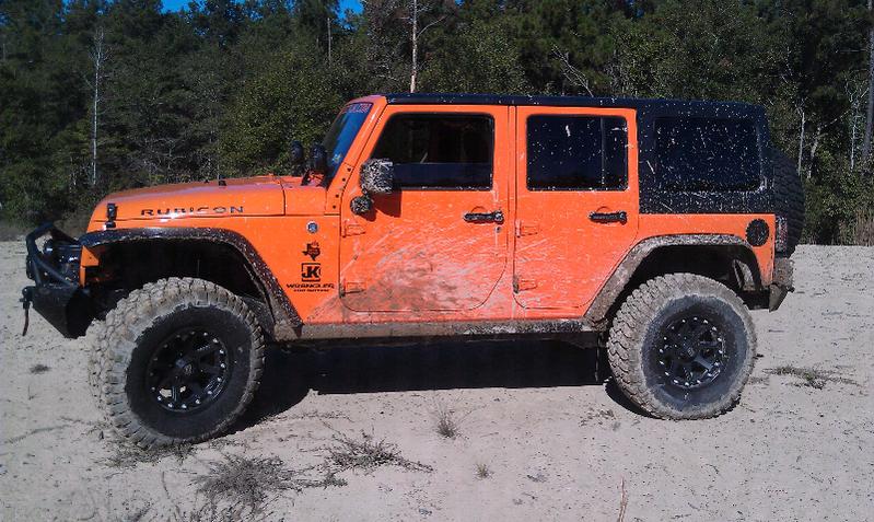

Well u can get a 1" body lift and be able to keep Ur tf2.5 lift. My setup is the teraflex 2.5 with a 1.25 rough country body lift on 37's. Trimmed fenders, pinch seams and rubi rock sliders. The reason why I got the bigger body lift from RC is because its only $100 on eBay compared to the daytar 1" for $195

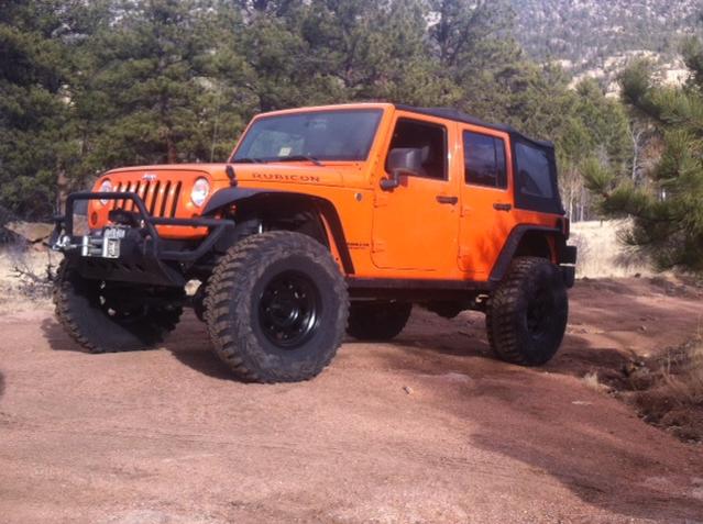

You can run 37's a 2.5" lift and flat/trimmed flares if you bumpstop correctly. Just wheeled all weekend with a friend that runs the RK 2.5 lift and 37" MTR's. It was a nice low COG and wheeled great. It did drag the belly a little.

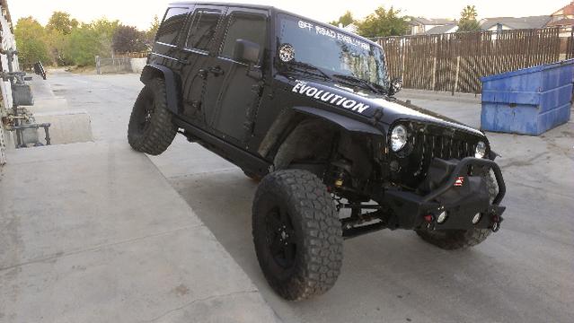

If you do 3.5 to 4" coil spring spring lift then the items you mentioned will be needed. The post above regarding the front axle work in on target. C gussets, a truss or inner sleeves and chromo axle shafts front and rear...and ball joints(the stock ones won't hold up). 37's will twist the axle shafts and bend flanges if you wheel it.

here is pic of 37's on the RK 2.5 lift
![](http://i68.photobucket.com/albums/i32/TChaap/Coal%20Creek%2011%202012/RK25.jpg)
Here is mine on an RK 3.5
![](http://i68.photobucket.com/albums/i32/TChaap/698FB7C1-3448-4C14-B9D9-88BE350790A2-12045-00000FB02D4EA07D-1.jpg)
I had trimmed my pinch seams and rock rails before, but had to go back and trim a good bit more to have enough clearance. I also added adjustable aluminum bumpstops made by a company called Rokmen here in denver. They come as a package and I actually had to add another 1/2" while in the trail to keep the rear from rubbing a little bit and it only took about 5 minutes total to do the rear on both sides.
