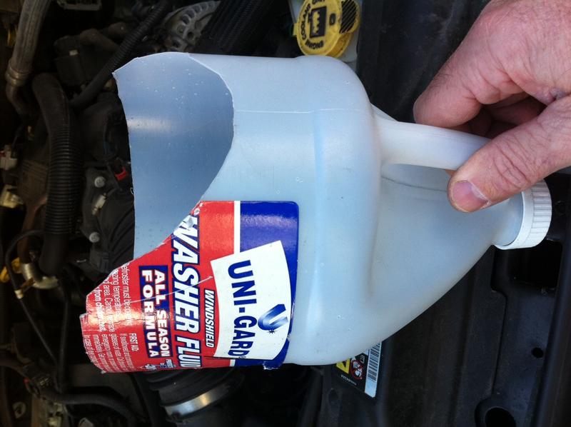

As for the filter, I make one of these "canoes" and rarely spill a drop. The one is the photo is cut a bit shorter than what I've been using lately. You can experiment for the best fit.
