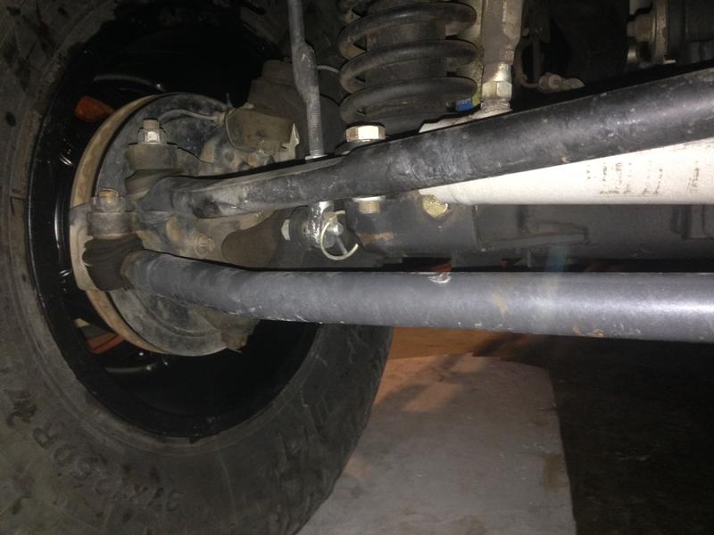

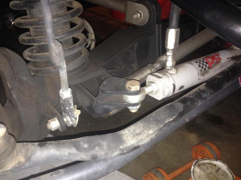

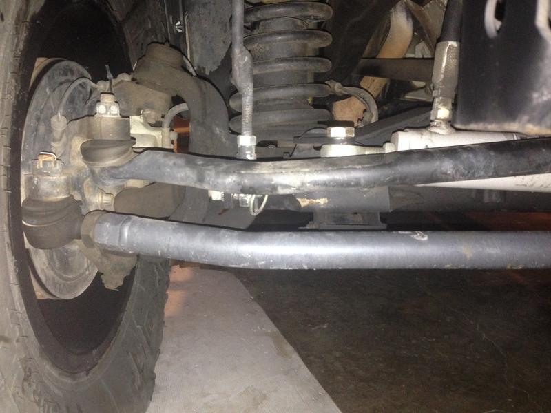

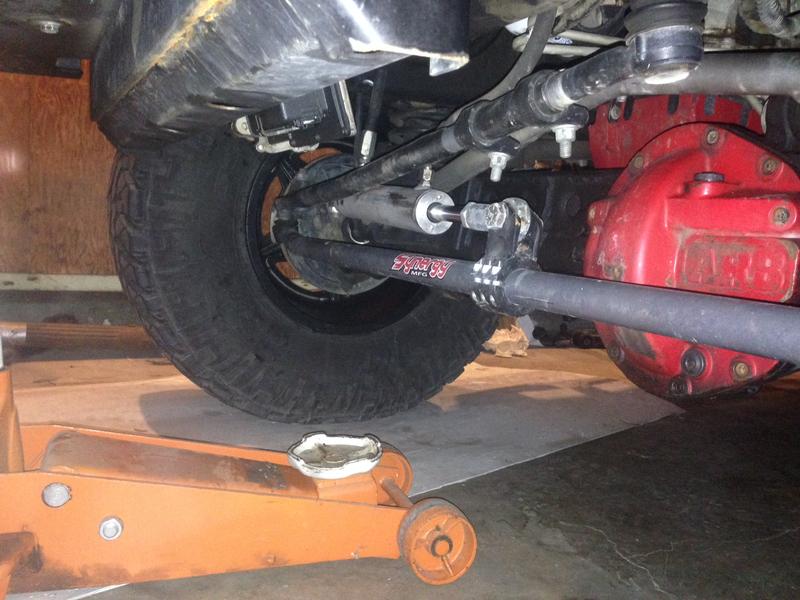

I'm in the process of install a Hydro Assist on my JK. I'm not having much of a problem, but I am curious as if anybody has done this before. Of course I don't have a drag link flip kit on my jeep so the fit is a little tight under there. I have an idea of how I want to install it, but if anybody has done this can you post up some pictures that would be awesome. Thanks
