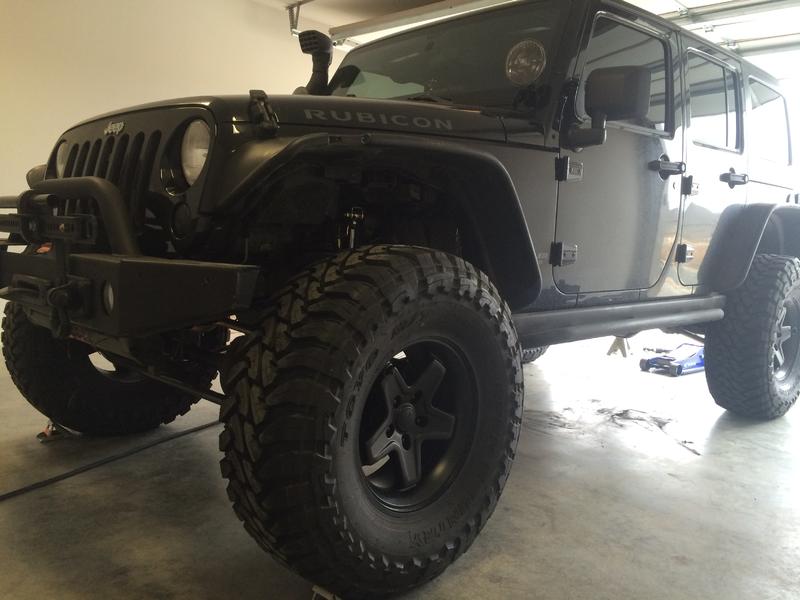

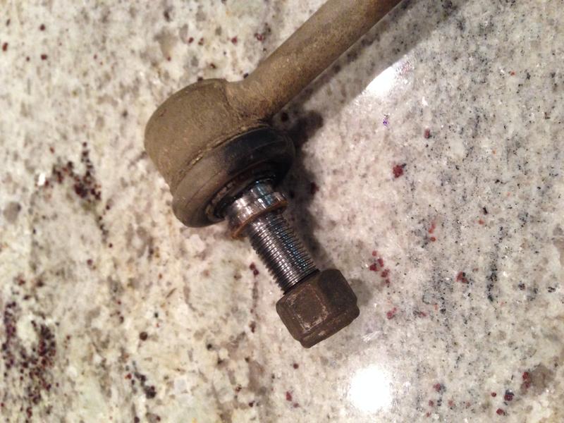

Hey guys, I'm in the middle of installing the Metalcloak Gamechanger lift. I've hit a snag on removing the rear sway bar links. They came from the Teraflex 2.5" coil lift that I'm taking off. The top bolt (the one that is embedded in the link) has no hex grip to get a wrench on to steady. So, when I try and loosen the bolt, it just spins and spins. I'm trying to avoid cutting it off, as I'm trying to sell this kit to a buddy when I'm done. Thanks for any help.
X 2 beat me to it. On inside of stud between sway bar & link hex head use open end wrench
