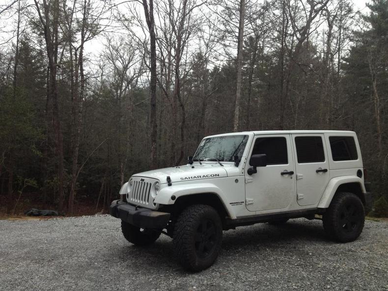

X2....I've had my Spidertrax on for 20,000 miles now. Use red locktight when you put them on and make sure to check them after 500 miles or after a hard wheeling session to make sure the inner nuts do not loosen. I run 33s now but plan on 35s.
