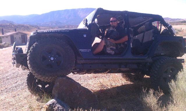

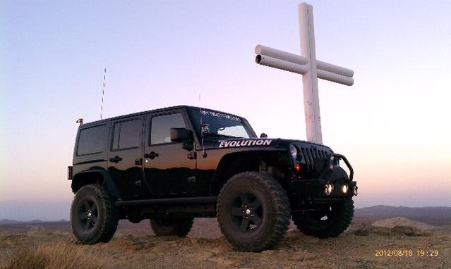

I'm running the 2.5" teraflex coil lift just under $500, 1 1/4" rough country body lift from eBay $100, spidertrax wheel spacers.on stock wheels $200, trimmed seams,fenders and rubi rock sliders on 37" km2's, no rubbing anywhere.
