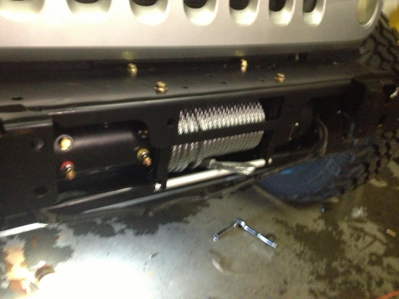

Sorry I didn't read your reply right (it was freezing in the garage, we ran out of propane for the heater), so here is a description of why it was in the way. When we mounted the winch to the winch plate and placed it between the frame rails, the motor side of the winch (on the passenger side) was hitting the rubber mount/isolator. We had to clock the clutch side to the rear about 60 degrees to be able to use the free spool option if needed as it was hitting on the crossmember in the front of the frame. As for the rubber piece pictured above (actually had metal within the rubber), we had to trim that back to get it to fit (with a little persuasion haha). The winch plate is a universal one that harbor freight had. We had to trim it a little to make it fit perfectly (and let me tell you, the winch plate was a PITA to trim!!! Even with die grinder!!)

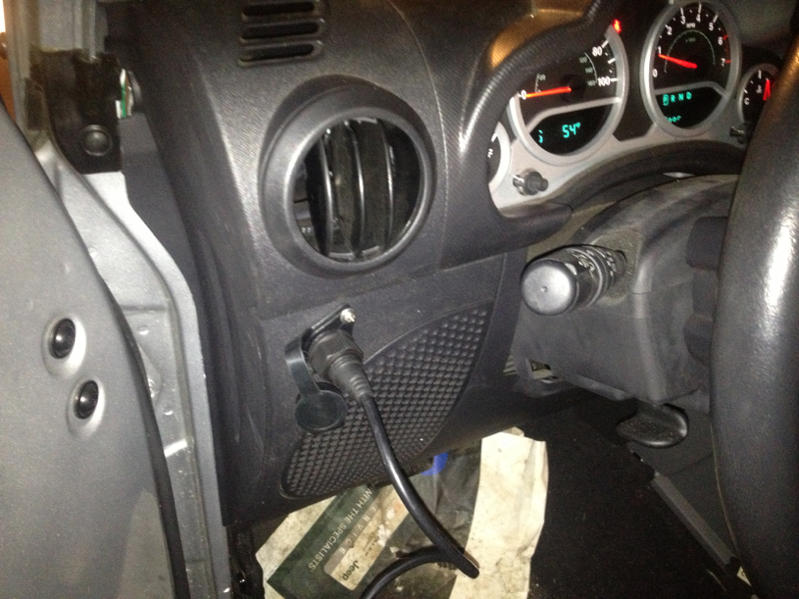

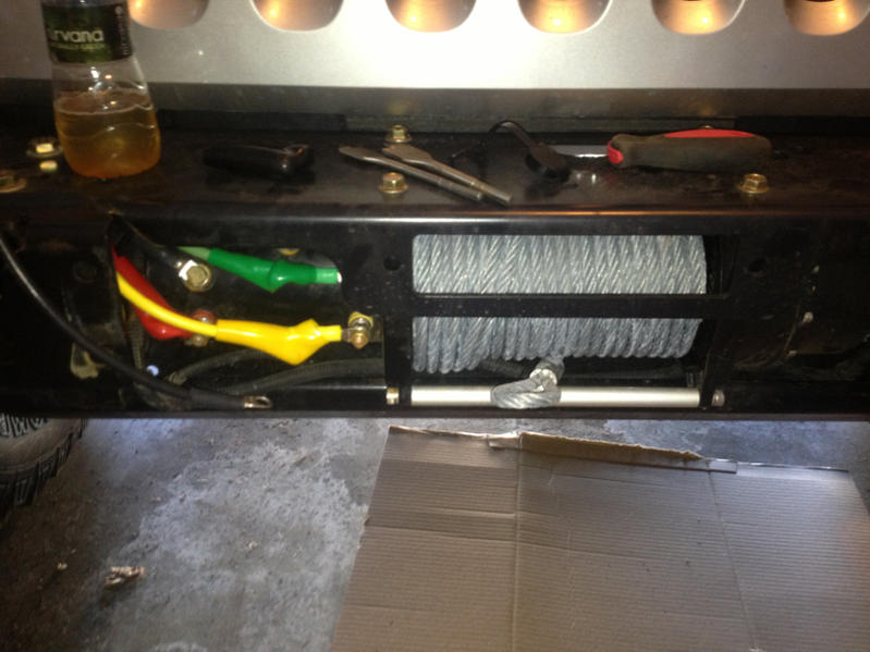

We were able to get the winch it's self mounted and the inner metal part of the stock bumper trimmed to fit the roller fairlead. We ran out of time and it was too cold to cut the opening in the plastic part of the bumper between the fog lights and run the wiring. He wants the solenoid to be mounted under the hood, and to have the plug for the remote inside the cab on the dash, so there will be some wiring that will need to be done very soon!
We ended up bolting the winch plate to the frame rails (in lieu of welding) using grade 8 bolts and drilling a few holes.
So far, it's coming out very well!! It is an extremely tight fit (I'm talking millimeters of clearance in a lot of places.
