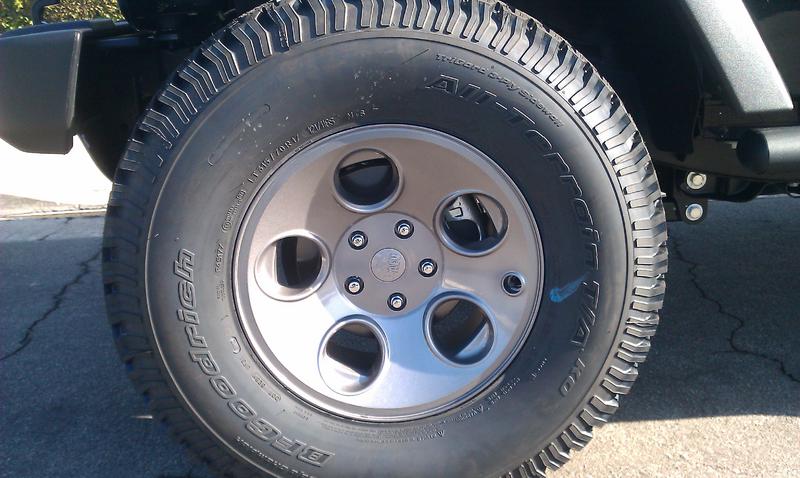

i have those exact tires. i played hell trying to figure out the difference between the two tires when i got mine. finally after a call to bfg i was told that the gm tire (the R rated tire) is NOT snow rated eventhough it does say that on the discount tire page. the gm tire is the oe tire for the hummer h2. the s rated tire is the oe ford tire and has snow rating and additional siping for wet traction. long storyy short the ford tire is the better of the two and its a little bit cheaper. i love mine...they are great on the highway and aired down offroad.![Click image for larger version
