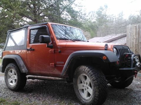

Just installed the JCROffroad Crusader stubby with skid plate on mine. Sticker on package said it weighed 83lbs. I forgot to measure a before and after measurement but I honestly can't tell if there is any sag or not. The ENGO 10k is going on this coming week so that will be the real test. I did however buy a 3/4 coil spacer just in case I do see a little sag but so far nothing.

I added a JCR dagger stubby and a Milemarker with synthetic...around 130lbs. Beforehand, I replaced the front 14 coils for some 17s. It sits higher now than it did without the bumper/winch. Without the spring swap, my guess is I would have lost 1/2 to 3/4".
