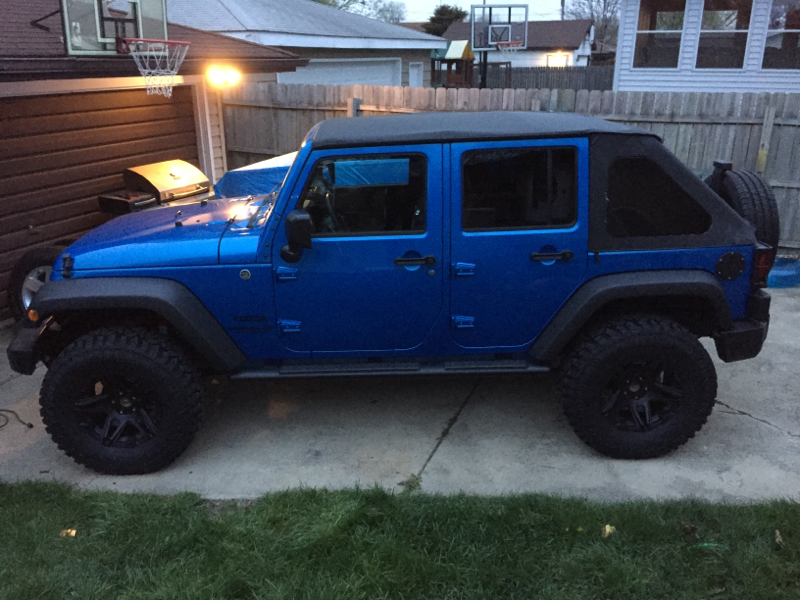

Purchased new rims and tires from discounts tire and am having difficulty mounting the rims to my jeep. The new rims are not hub centric. I called discount tire and they are telling me all aftermarket rims are lug centric and not hub centric? Isn't this a safety issue? I had always heard that rims should be hub centric to properly fit the vehicle. I am having a heck of a time even mounting the first tire on my wrangler. American outlaw rims with 35" coopers. Any help much appreciated and thanks! 2015 Hydro Blue JKU

Thanks for the quick replies guys!!!!
I finally got the front on.
The lug opening on the rims are pretty small and I am having to rotate the wheel to get the lug wrench in the hole to tighten the lugs down.
I am going to order a set of those hub ring things you guys are talking about so it's easier to mount the rims.
Thanks again!!!

So the issue is your lug wrench is too large? Hub centric rings won't help you with that. Gorilla splined lug nuts help. I purchased the eBay ones and they're the same style but much lower quality and have a terrible finish.
