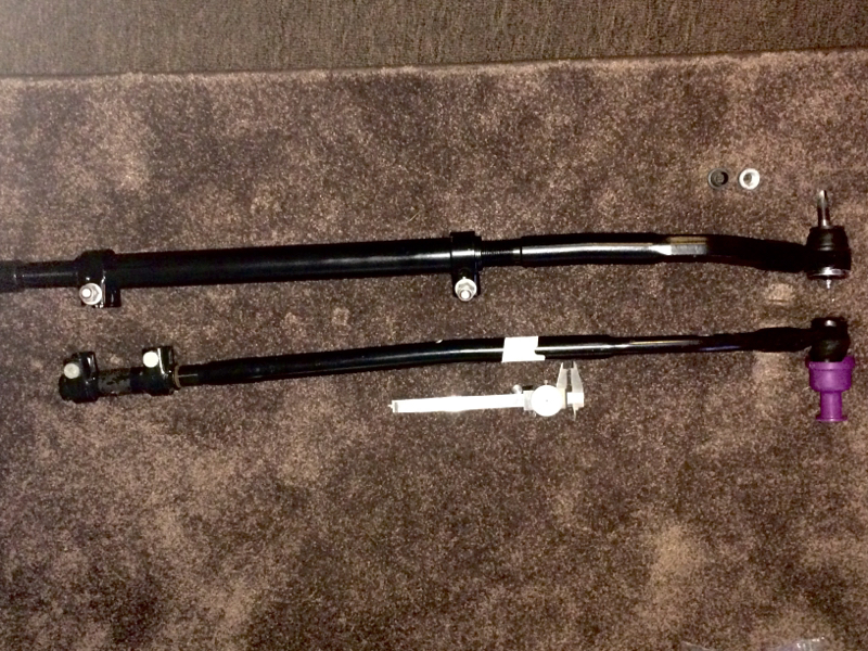

While it may "not" mask other issues, it definitely doesn't do anything about replacing the weak flimsy stock link and ends.
To me it's like getting a sleeve hammered on to your bent tie rod. Still removing it, still working on it, but instead of replacing it, throwing money in hopes it will help. When the real solution is buying a new damn tie rod.
In other words, still buy another drag link with popular rod ends, greasable, serviceable, for literally less than 100 dollars more. While it may "not" mask other issues, it definitely doesn't do anything about replacing the weak flimsy stock link and ends. To me it's like getting a sleeve hammered on to your bent tie rod. Still removing it, still working on it, but instead of replacing it, throwing money in hopes it will help. When the real solution is buying a new damn tie rod.

The yeti tie rod is a beast, very high quality. I remember referring to it specifically because of a past post. It's nearly 400 if I remember right, but worth it. Adding another 1 and change fur the kix is a big chunk, nearly like just going with a Carolina metal mashers jk high steer. I drool when I see that thing. But practically speaking, my front axle situation will change.
That's the one with the reverse mounting, no drill high steer dealy But yet again, with the new and vastly improved material strength does this still become necessary? The yeti tie rod is a beast, very high quality. I remember referring to it specifically because of a past post. It's nearly 400 if I remember right, but worth it. Adding another 1 and change fur the kix is a big chunk, nearly like just going with a Carolina metal mashers jk high steer. I drool when I see that thing. But practically speaking, my front axle situation will change.
