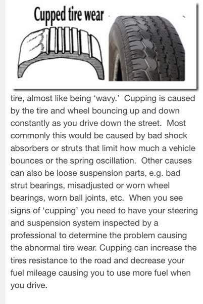

Does it look like every other block is worn more? Looks like cupping to me. I had the same issue when got bigger tires with stock suspension and it disappeared when I got new suspension. It is easily corrected with tire rotation tires wear back to an even wear or having your shocks checked. Click image for larger version
