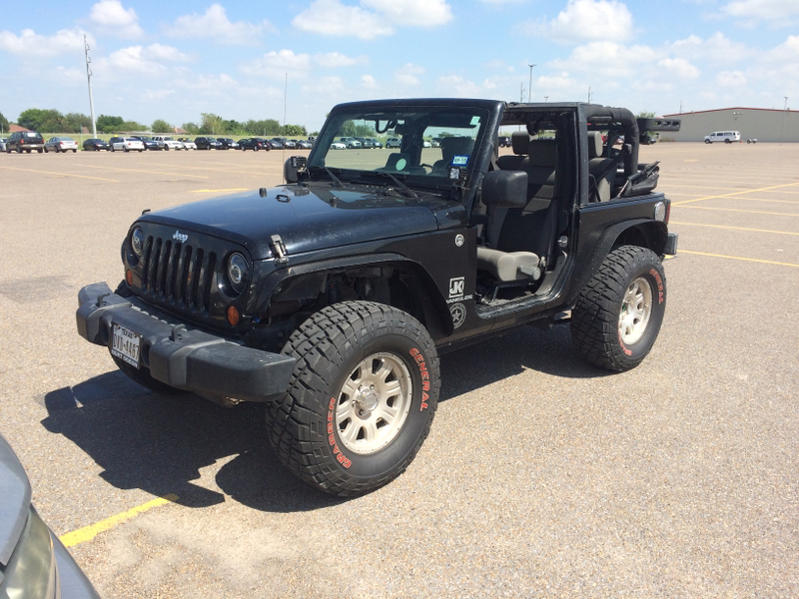

Xenon Wide-Flat Flares. I had to go wide to get tire coverage between spacers and backspacing changes. I did destroy one on the trail and ordered a replacement no problem. It flexed a huge amount before it finally broke. Not Xenon's issue at all, I had it up against a tree. I bought the originials used, they came with the plexiglass supports used to keep them from getting droopy when they soften in the heat. Sanded them down, self-etching primer, couple of coats of spray on bedliner later:
It looks a little different now (all grown up)
