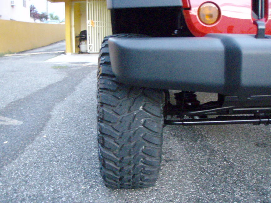

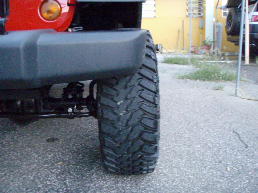

It's been about 4 days since I had my JK lifted with a Teraflex 3" lift kit along with a few other things like the TF front adj trackbar, a full set of Superlift adj control arms and a set of 1350 driveshafts(front not yet installed). I'm waiting to install a dual SS from Rough country, but first I want to make sure that everything else is dialed in.
So far no vibes, no serious bump steer, no death wooble and handles better than expected but my JK tends to drift to the left ever so slightly when I let go of the steering wheel on a straigh flat road. Yes, I did take it for a alignment and to my disbelief I was told that I didn't need to align because everything was with in the recommended specs for a lifted Jk with 35" tires.
What else could it be or I'm just being anal?

You might try a different alignment shop. It looks good in the pics, but hard to tell sometimes by eyeballing it. Also, make sure the alignment shop checks your thrust angle alignment.
