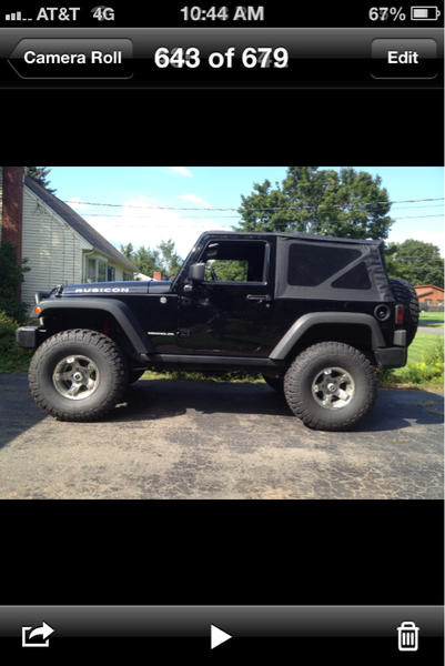

Since you already have a BL, do something like Teraflex or RK 2.5"
The heavier springs will give you more than enough for 37's. trim the flares 40's.
The biggest contributor to ride comfort is the shocks IMO
The Rancho 9000's are on sale now and ride awesome with my RK coils.
Should be able to hook yourself up for around a grand.
2 door w/ RK 2.5's and 35's.
