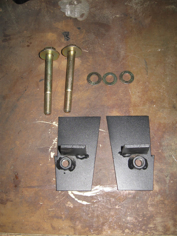

I just got done installing my new Expedition One bumper and tire swing. I'll post a writeup once somebody helps me figure out what these parts are for. I don't see them in the instructions or on the youtube video of the install. I ordered the extra cb mount and got that installed, so pretty sure they are not for that. I'm thinking you are supposed to drill a hole through the frame cross member in back for extra support?
I had E1 custom build my bumper with a 2" receiver in it. Maybe they included these brackets and bolts for extra support?

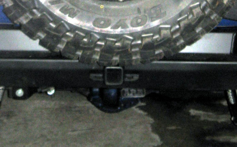

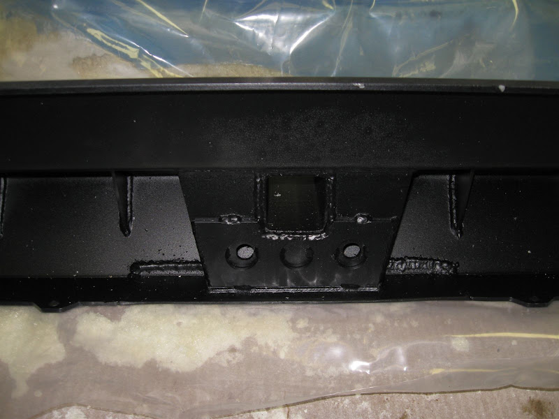

here are two photos of the reciever. One from the back before install, one from the outside after install.
I noticed two holes in the bottom of the bumper where it curls up under the frame cross memeber. Did anybody else get these parts with their kit?

I don't remember getting those parts however it's been a long time since mine was installed. I would just call them.
I definitely didn't get those parts in my kit.
Looking at the length of the bolts I'd say your correct to assume they are for extra support for your receiver.
Here is a pic of my receiver before the bar went on which may help you out.

no instructions!
