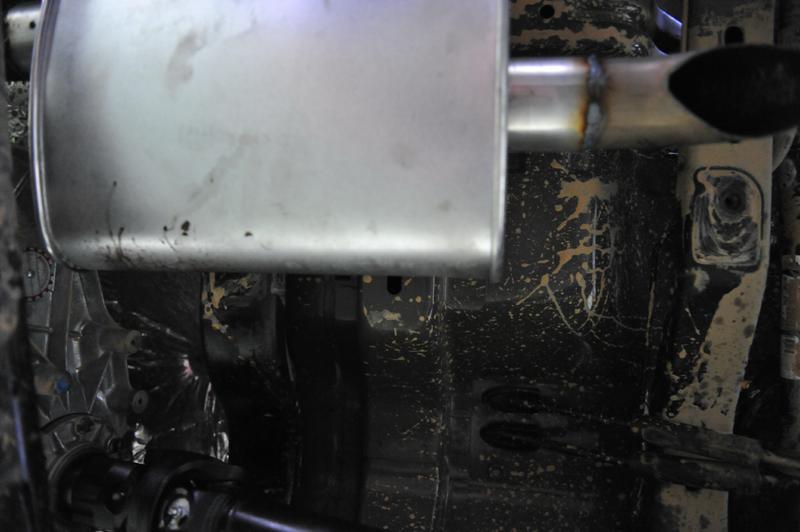

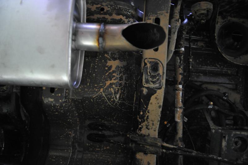

Here are a couple of images to give you an idea. Lens angle is not wide enough but still you might get the picture.
(Don't know if I have enough posts to attach images yet - we shall see...)
Attachment 368679
Attachment 368680
Attachment 368679
Attachment 368680

Thanks for the part number. I'll order it. Current muffler is 14" so 19" should also add some quietness right?
I don't think there will be enough space for a bullet if I go with this 19" muffler unless I go with a really short 6" bullet. Is that worth it?

I just looked up the P/N 17956 and the length (19") same as my current muffler.
Would using P/N 17959 length 21" not be better?
Also - would using "over 4.0L" version of the same muffler be better/quieter than the "upto 4.0L" considering the engine is 3.6L ?
Thanks again for your time !
P/N 17959 is off set/off set so shouldn't be an issue fitting in that space, it will just be at a bit of an angle I am guessing.
We suggest the over 4.0L for the JK platform because of the heavy bumpers, tires/wheel and suspension mods that get added most of the time.

I've just ordered P/N 17959.
