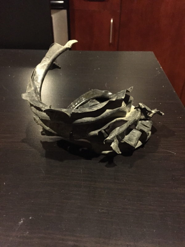

Just do it. I've lost two stock driveshafts in 3 trips. Here's the boot from today's trip.

How much lift do you have that you ripped two boots already?

First was stock. I'm not sure if it pinched the cv boot or a stick hit it. The second was with 1.5" RK springs and OME long travel shocks.
