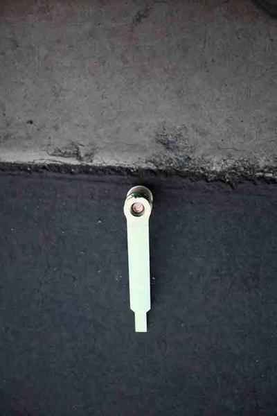

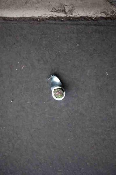

Now for the passenger side... I got it mounted and holes drilled. I went to install the short armed bolt when this happened with just a hand socket wrench:
That is as far as it will thread by hand. It refuses to go through the nut and bent the heck out of the little arm. It wasn't fun trying to get it out.

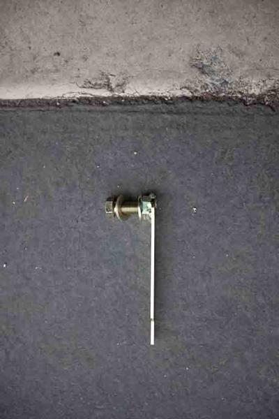

I'm afraid to do the long armed one because it too does not thread all the way through the nut:

I just got off the phone with Andrew and yeah, I'm missing the largest bolt pack. It figures, the most obvious thing missing (if you know what to look for). We ran down the inventory to make sure I had everything else and it looks good.
He's also going to send another passenger side 9/16" frame bolt set. They're lock nuts and aren't supposed to be hand cranked but I'd rather just throw some locktite on and have them thread all the way through. I'll throw a pair of vice grips on before I start it again just to make sure it doesn't bend as badly.
