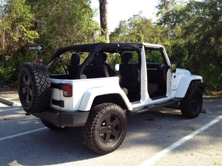

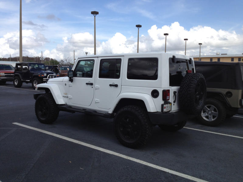

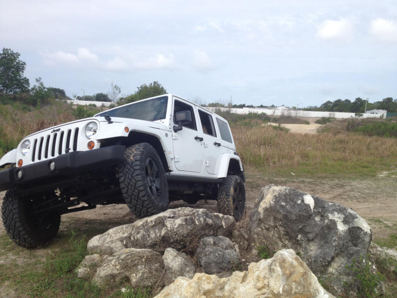

Your rig looks great. I was wanting 18s so I get the better handling for on-road, or so goes the thinking. Yes I know its flame-worthy ;-). So you didn't take a big hit pickup-wise when you went to the bigger tires? This is my first jeep, finally pulling the trigger given the bigger engines starting this year, so I'm just a bit nervous about it being more sluggish tha it has to be. Reasonable concern?
Join Date: Oct 2011
Location: Pfafftown, NC
Posts: 98
Received 0 Likes
on
0 Posts
You'll not notice any difference going from stock to a "32/33" tire with the 3.73s and new engine. I went from stock to 35's but being an 07' it came factory with 4.10 gearing and the 6-spd is fine. I still set cruise at 70 on the highway in 6th.
As for the potential to have better handling with a 18" wheel again i'd bet you'll notice absolutely no difference on a 17" wheel. Except for the much more abundant tire's available, cheaper prices (wheels and tires), and less weight. Now if we were talking race car that may be a different story but still not by much.
As far as on road handling goes...I have not had 17s or 15s, but my thinking is that if you ran a higher PSI like 35-38 you would have plenty of responsiveness. I run mine at 28 on the street which gives it a softer ride for absorbing bumps etc.
I did notice a little difference on my acceleration with the 33s, but I am running 3.21s.
If you are running 3.73s you will be fine IMO, but I also think weight would be my determining factor on the tire selection. Try and keep to 55lbs or lower on your tires and I think you will be just fine.
