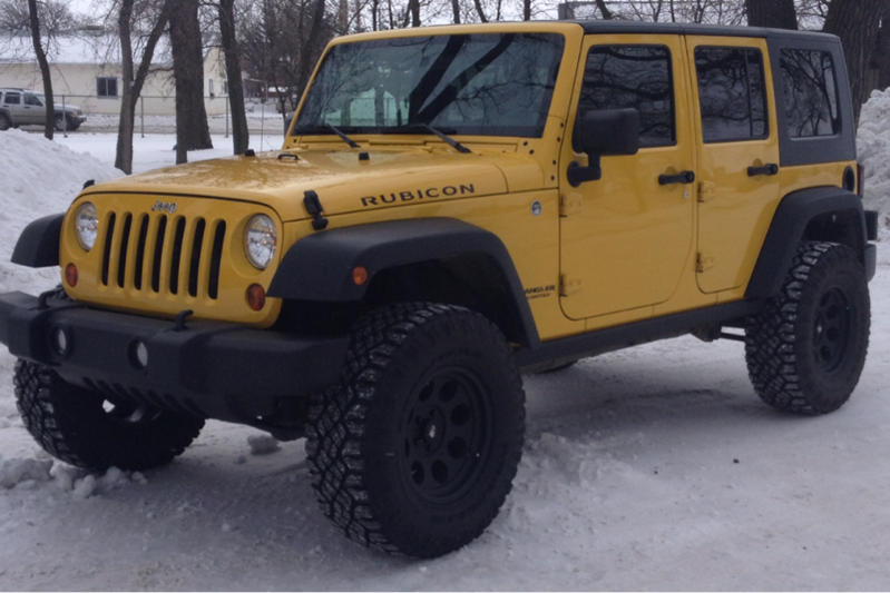

I installed my 315 70 17 duratracs two months ago. They only measure 33 3/4" installed on my jeep. I don't have aftermarket bumpers on either. There is a definite difference having the 3.73 but not horrible for me. I also installed the teraflex sleeve and gusset kit and I have the aev procal. The cost of the sleeve and gusset kit was nothing compared to a shot d30.....
