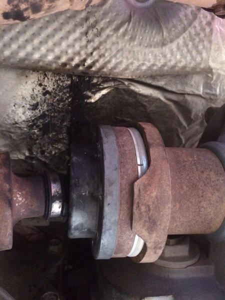

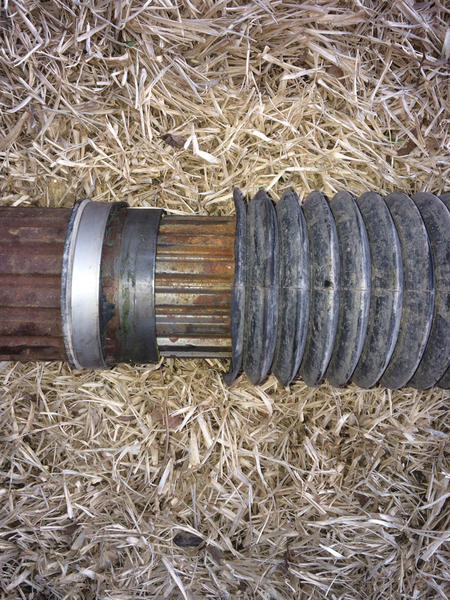

Boot over the slip joint isn't a big deal. Where I'd bet a lot of money is the rzeppa joint at the transfer case on the front driveshaft has failed.
This joint = no real big deal
This is the big deal and a 4" of lift, even a pavement pounder, will eventually fail:
