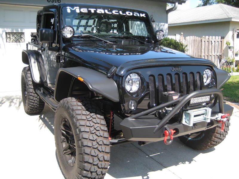

Hi guys! I'm new here. I have a 2015 JK. Has anyone installed this grille mesh on you JKs? I need some help.

I also vote for buying mesh at lowes/HD. I did mine last year and cost me less than $15.00 I think.

Dude, save your money. Go to home depot and get a gutter guard. You can get plastic or metal. I got metal so I could paint it. Get 4" zip ties and 1"x1" anchors. 20 min and you'll be done!!

I just went to a metal work shop and they ordered some in for me. Didn't need to tie it in. If you cut it right there are some bits inside the grill that stick out and you can simply clip into those. They hold everything rock solid if you get the cut right.
