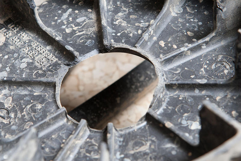

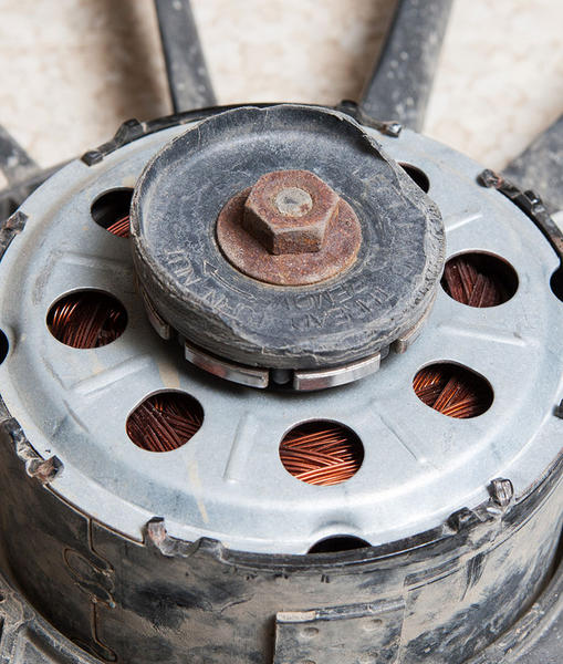

Well, here is my first break down, and it's the fan Not a big deal, as I turned around and made it home fine without overheating. But here is what happened. The plastic fan blade completely broke off from its shaft:

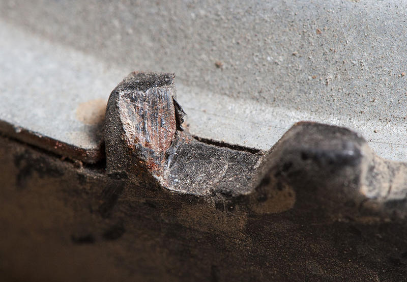

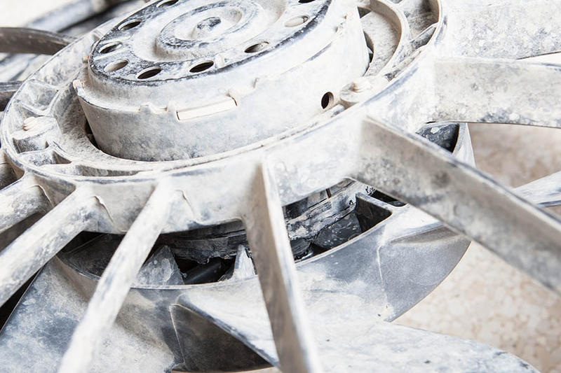

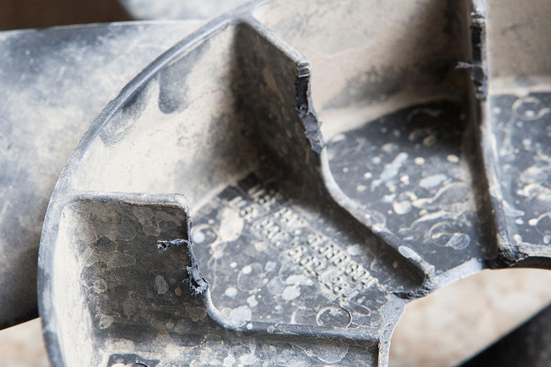

I guess a rock got caught inside, stalling the fan and eventually breaking off the blade. There are some obvious marks of a foreign object being struck inside:

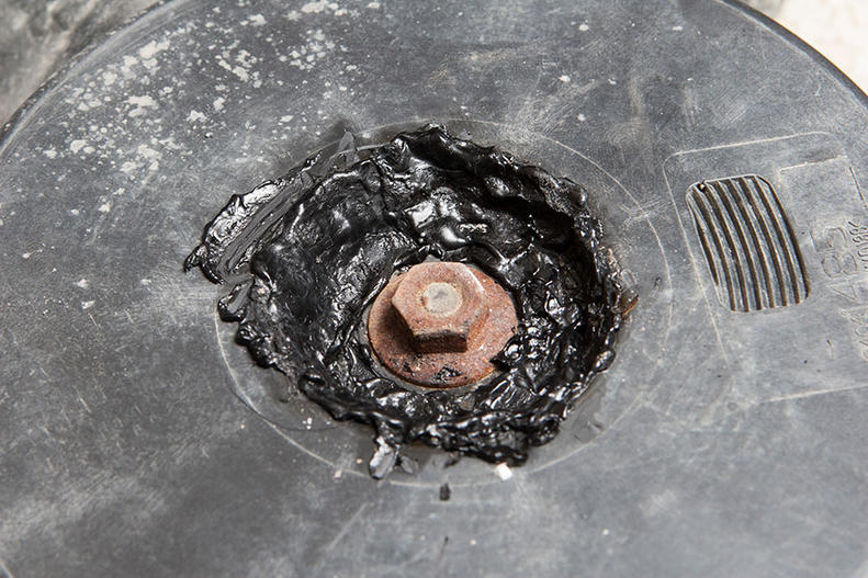

So as a temporary fix until I get this fan replaced, I soldered the hell out of it back to the shaft:
Tested it a bit and it's holding fine for now.
