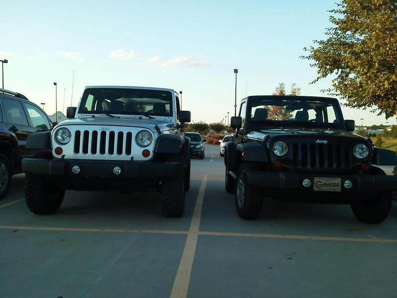

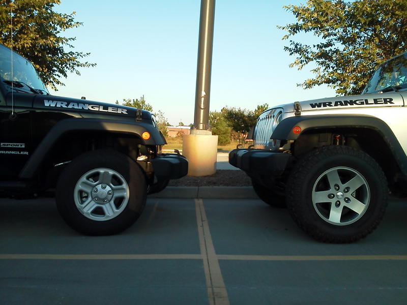

you will be adding 3.5"-4" of lift with the longer springs (higher number springs are physically longer not stiffer) and spacers, you can stick with stock shocks but you will really be limiting your down travel if you are planning on off roading. I went from 14/55 to 17/58 along with 2" spacers, even the longer shocks that came with the 2" BB were limiting my down travel, I am currently running Bilstien 5100's for a 4" lift up front and a 3" lift in the rear. I did need to extend my bumpstops and brake lines.
17 vs 14 spring 1.5" taller

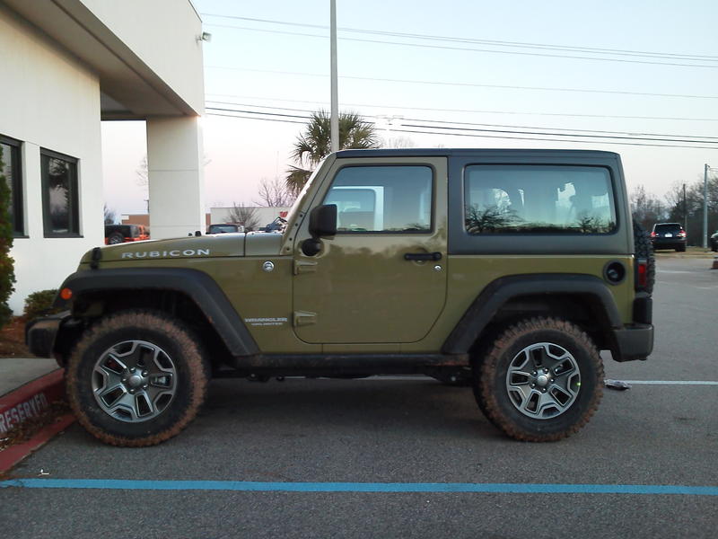

I have the 19-59s so ill let you know my experience. With these coils I gained 2.25 inches up front and 1.75 in the rear and it sits level if measuring the pinch seam behind the front tire compared to the pinch seam in front of the back tire. Same exact measurement. I would think adding a leveling kit to an already level vehicle wouldn't look so good. Unless you have a really heavy front bumper. I think I need longer brake lines now. Atleast those extender brackets. If you added the kit on top of the new coils you definitely would want extensions for shocks and brake lines. I cut my fenders and added 35 tires and my jeep sits high enough that I have to hop in. I'm 6'1. Also I think you would need new trackbars for it to be right. Like the guy said above you would be adding around 4 inches to the jeep you have now. Look at what comes with a 4 inch kit, that's what I would feel safe with, nothing less.
