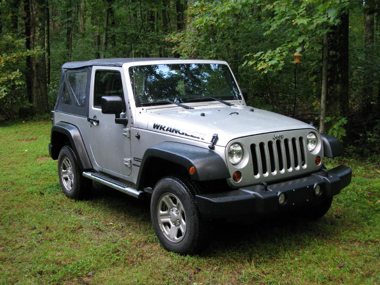

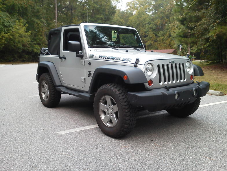

I wnet from 14/55 to 18/59 springs and Rubi shocks, wheels and tires. Including 1.5" Spidertrax spacers. Very happy with results. I will add leveling kit down the road.
Before
After
Before

After
