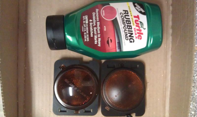

I've been looking on google a lot and finally found a very good write up on a mustang forum. I don't think the type of clear coat matters a lot. Something for outdoor plastic. I used rust-oleum paint for plastic. I polished the lens for a half hour with a rag. I occasionally applied more product then just wiped off the haze with a clean rag at the end. I kinda used some firm pressure. The polished one is smoother and reflects light more. Let me know if you have any other questions.
