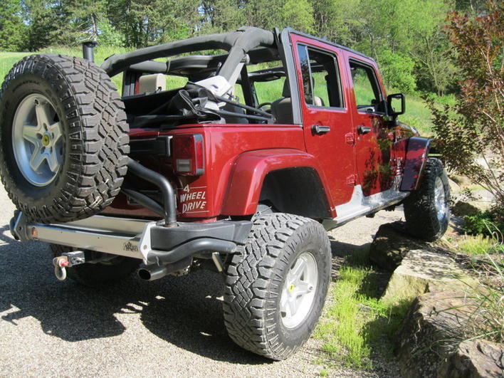

Fellow JK'ers, Some may recall my previous thread whereby i described my oil consuming 3.8l engine and various options to fix/replace.
The progression of ideas has lead me to the following choice for my 2010 JK 4dr Sahara auto.
Current mods include: AEV 3½" lift; 4.88 gears and lockers; AEV hood, bumpers, wheels; 35"s; intake & exhaust.
