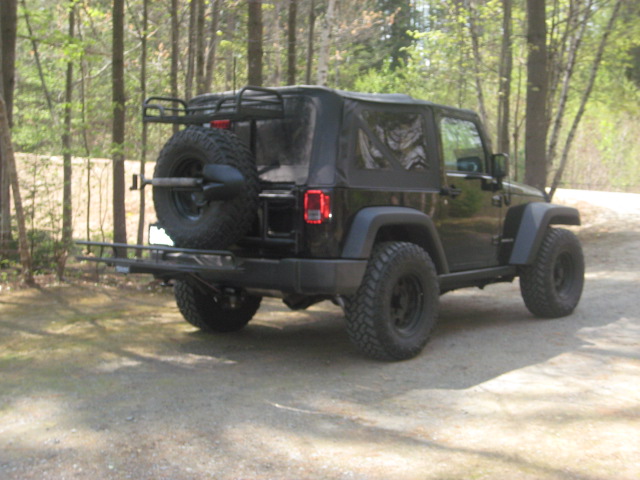

Old 07-19-2015, 02:20 PM
jeepmojo's Avatar
Join Date: Feb 2011
Location: New Hampshire
Posts: 2,318
Received 12 Likes on 8 Posts
Default i have 33s but 16 x 8.5 i believe
i have 26,000 miles and wearing perfect no lumps or bumps at 30 psi chalk tested. i would think adding air will cause more center wear . They had 80 psi when i recived them from dtd lol. but its prob a shipping reason only id hope.
