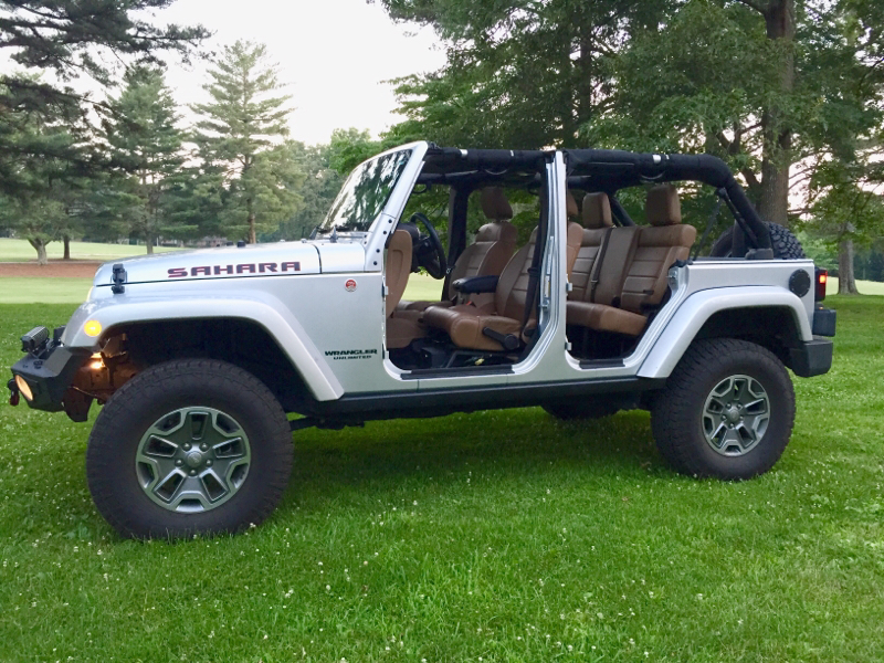

Yep! Nitto Trail Grapplers 285/70/17 gonna rub the inside of your tire on the swaybar. From what I understand spacers will put no more stress than rims with the same backspacing on your axles.

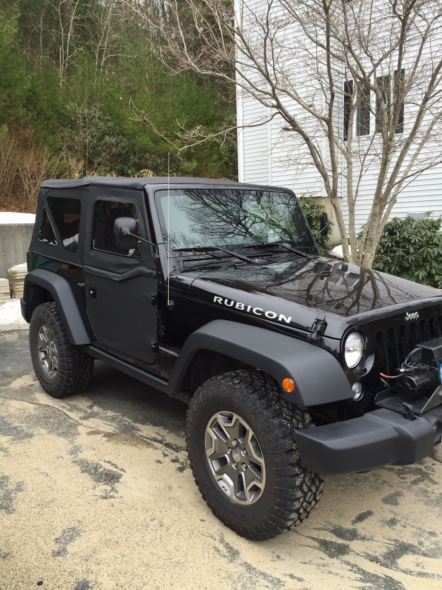

I run 285/70R17 Duratracs on stock Rubi rims. I put 2 washers on the passenger and drivers side steering stops and have no rubbing at all.

I haven't noticed the change in turning radius. It's pretty insignificant. Putting the washers on the steering stops is a very quick easy mod. Takes literally 5 minutes. Each wheel has a bolt that contacts a point on the steering knuckles. Turn your wheels to full lock and you'll identify them. Remove this bolt, insert 2 small washers and reinstall the bolt. It will appear that the bolt is welded in place. This is not the case. There is a "stop" nut welded on the bolt.
