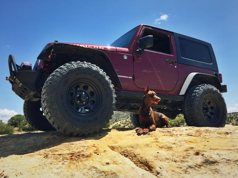

I've got a 2010 3.8 rubi 2dr with 70k. I had 33s on 1.5" spacers and in the last few months I've seen a drop in MPG from about 14 around town to about 11 in town. I don't haul ass, but I have plenty of stop and go. Most speed limits in town are 35, probably max 50.
Then, like the bright young lad that I am, I sprung for new wheels and tires (37 MTR/Ks on 17 Black Rock Steel). Now (naturally, this hasn't helped...) but I'm getting 9.8mpg
From what I understand, guys with similar setups are getting 30-40% better fuel mileage than I am (at least 13 or 14 MPG). Is this reasonable? Should I worry?
